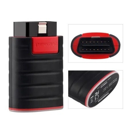

    Und wie ist es damit ... hat das einer von euch?
    Universal Diagnostics Interface Easydiag 4.0 Thinkcar with X431 Software
    New original Diagnostics Interface Easydiag 4.0 Thinkcar for many car brands. It works with an Android device and transforms it into a powerful diagnostics…
    diag.ecwid.com
